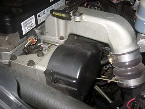

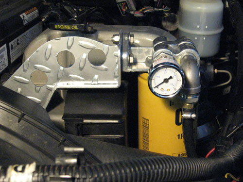

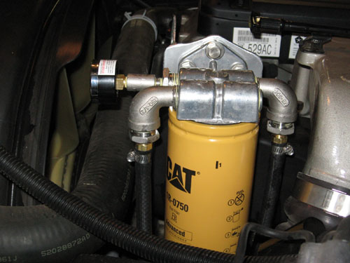

I now have my Cat 2 Micron mounted.. After doing a lot of research and reading of post and asking lots of questions as some of you know. I decide I wanted my remote filter under the hood where it would be safe & out of the weather. I was able to put together a Cat 2-Micron filter system for my truck that has the APPS and the filter is mounted under the hood. After giving it some thought I was able to take some scrap metal and build a mounting bracket that sits over top of the APPS. Now the fuel is running into my stock fuel/water separator canister where there is a PF7977 5-Micron then it runs into the Cat 2-Micron filter. So now I should have nice clean fuel running into my injector pump. Everything worked out great...
Before anybody says anything! I don't have gauges on my truck as of yet. So I added the gauge just for fun to dress it up & also it does give me a way to check fuel pressure if I think I'm having a problem. I know the gauge isn't going to last long being it is a dry gauge but if I decide to leave the gauge in I'll replace with a liquid filled gauge.
Thanks a lot for all of the information that was shared. As always there is a great bunch of guys on here....Let me know what you think!

The fuel line between the Fuel Canister & Injector pump which is metal. There is a section joined with a piece of rubber hose. You can make your connections there.
The gauge I have mounted in on the exit side of the filter it's running 7 PSI at idle. From what I have found out as long and you keep a watch on the filters and don't let them plug up you should be ok....
