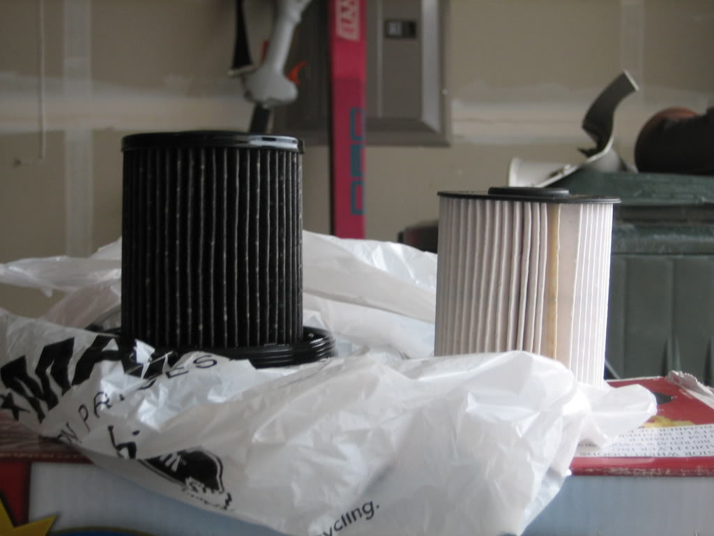

The filter turns black from the asphaltene particles in diesel fuel.

On my '89, '02, and my '06, all were changed at 10,000 miles and all were black. My buddies '06 the same thing. I wouldn't worry either that or we ALL have a big problem

MikeyB nailed it. It's a non factor if you change the filter as spec'd, at least. If you're cheap and don't like to change the filter, FleetGuard makes a Asphaltene Fuel Conditioner to deal with it. At least the Asphaltene that is.

Now that my OE filter is 2nd in line it's no longer black at the filter change, but I bet the 1st filter is!

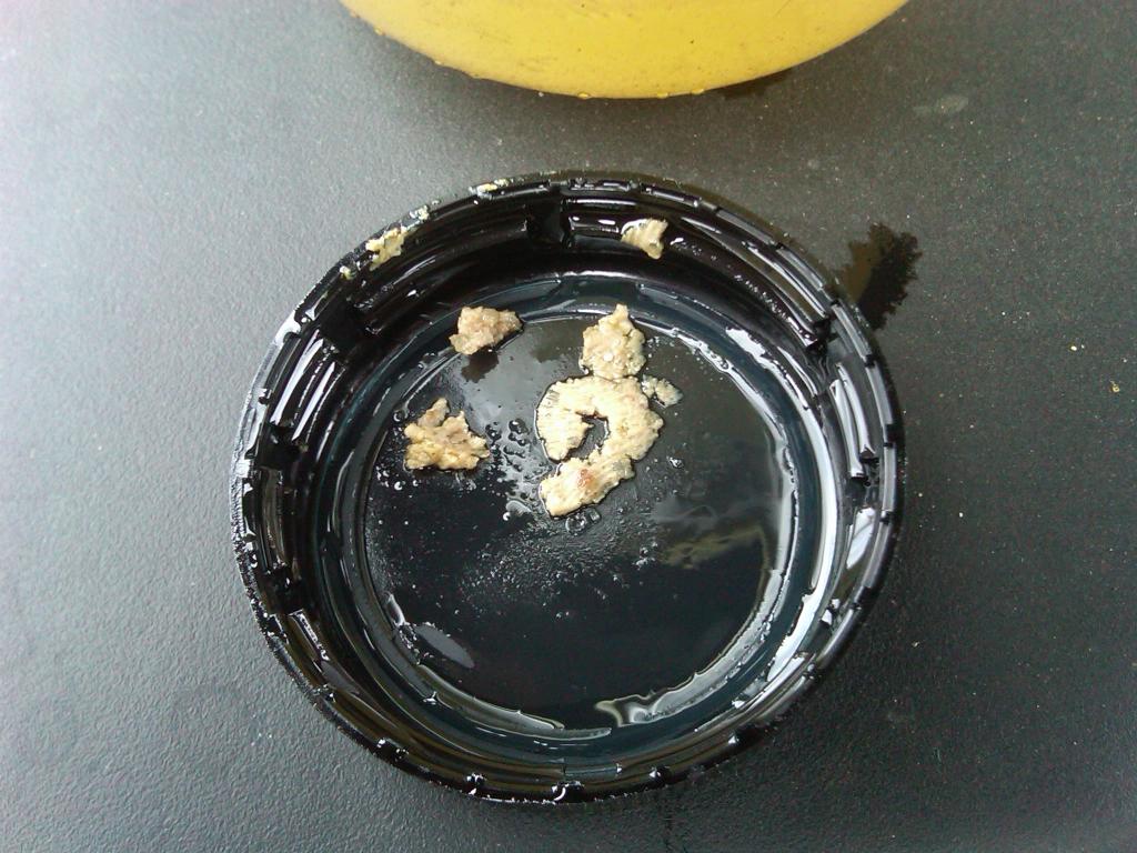

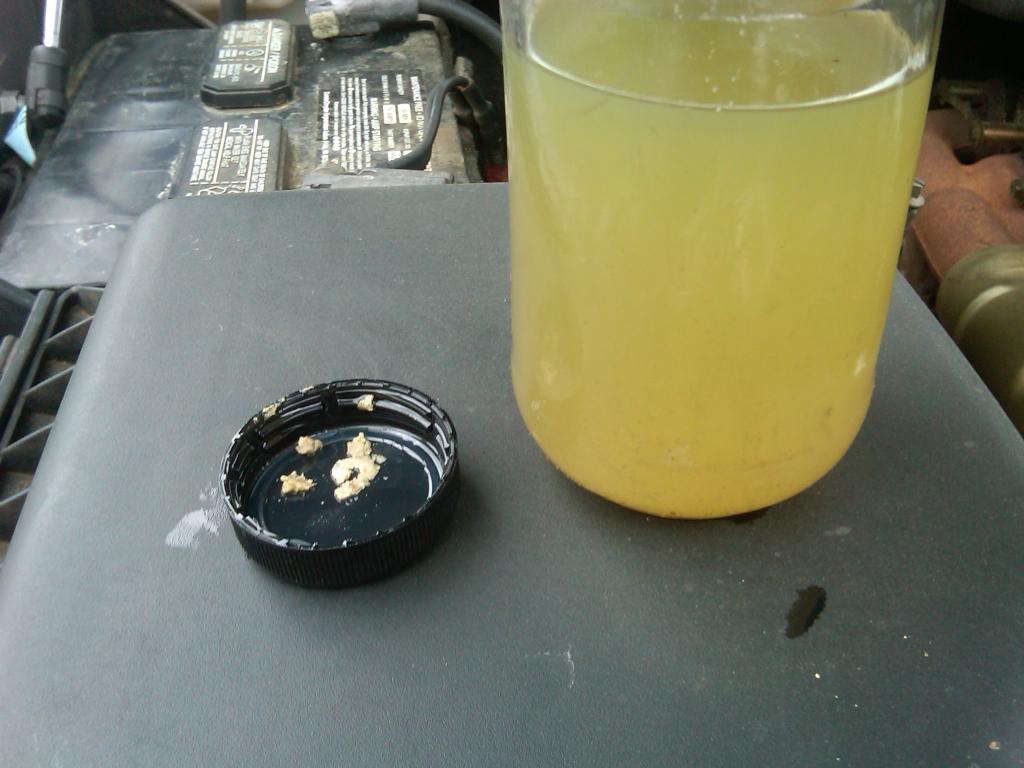

Ok here you go... I never expected to find this stuff that looks like gritts at the bottom of my fuel filter housing. The Diesel in the Jar is after I got the rest of the crud out of and in the jar. and the stuff in the black cap is what I got out of the botom. 180 gal of 20% Bio burned. Any Ideas what this stuff is????

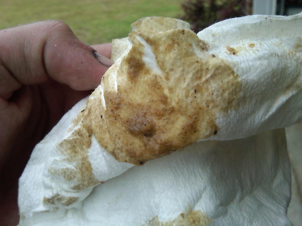

I got one more for ya. it took me 30 min to get all this stuff out.

Looks like the filter is doing its job!
That looks like residue from your biodiesel. You may have gotten a batch that wasn't properly manufactured. The fuel in the beaker is cloudy. Is it contaminated or aerated? That may be your answer!
Old Apr 4, 2011 | 07:45 PM
PoorMansCat's Avatar
Posts: 530
From: Marshall, Texas
looks like chicken fat.... Should have bought "free range chicken"
That is funny. Then the exhaust will smell like a free range fart...sniff it up...good for ya.
The diesel in the beaker is contaminated. I did the old KC-130 fuel sampel sworl to create the vortex to get as much watter and contaminints to the center and that is what I got. I am glad the filter did its job. Could it bee any of the stuff in the lines that the bio may have cleaned out. I hear bio cleans alout of junk out of the fuel system??
