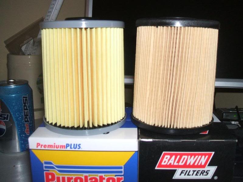

Here is what mine used to look like:
Yeah I know I have used fuel filter pics...it was for a report during college. By the by those are purolators fuel filters like 18 microns DON"T USE!!!!

Thank you all for your replys and help and for the two links that were posted, you all made me feel a hole lot better. rufushusky my old filter was the same color as the black on the baldwin filter box in the 2nd picture.
