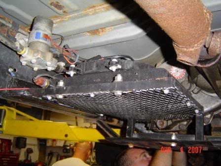

Here's my trans cooler. I have a Airdog now after the Holley died.
In the first pic in the thread below the line on the left has check valve in it. I just took the fitting out (actually it gaulled when i took it out so i had to replace it anyways.) cut the line and replaced it with a 1/2"npt X 1/2" tube fitting.
