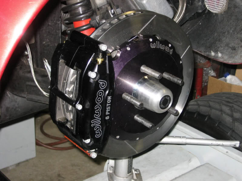

I race sports cars for a hobby. Brake technology is very important. Good brakes can shave off 1-2 seconds per lap. That doesn't sound like much, but it is. proper brake pad compound selection is the differance between first and 5th. It's sometimes easier and cheaper to improve the brakes than it is to improve the engine.
These are the front brakes on my race car. Notice, there are no holes in the surface, and only a few slots. These brakes will almost make the car stand on it's nose. Lap after lap.
They can withstand some pretty high temps, too, like 500-600*. You never set the parking brake after a race. The pads and rotors are so hot, they will weld themselves together. That's hot. That's what I mean by severe duty track use. If you're getting your truck brakes that hot, you're definatly doing something wrong. And drilling a bunch of holes through your brake parts is not going to help.
Now, I'm sure you've read through this, and said, "What a bunch of drivil". So, go to the Wilwood and Baer Brake web sites. Look it up. They'll tell you exactly the same thing. Drilled and dimpled rotors are for bling only.
