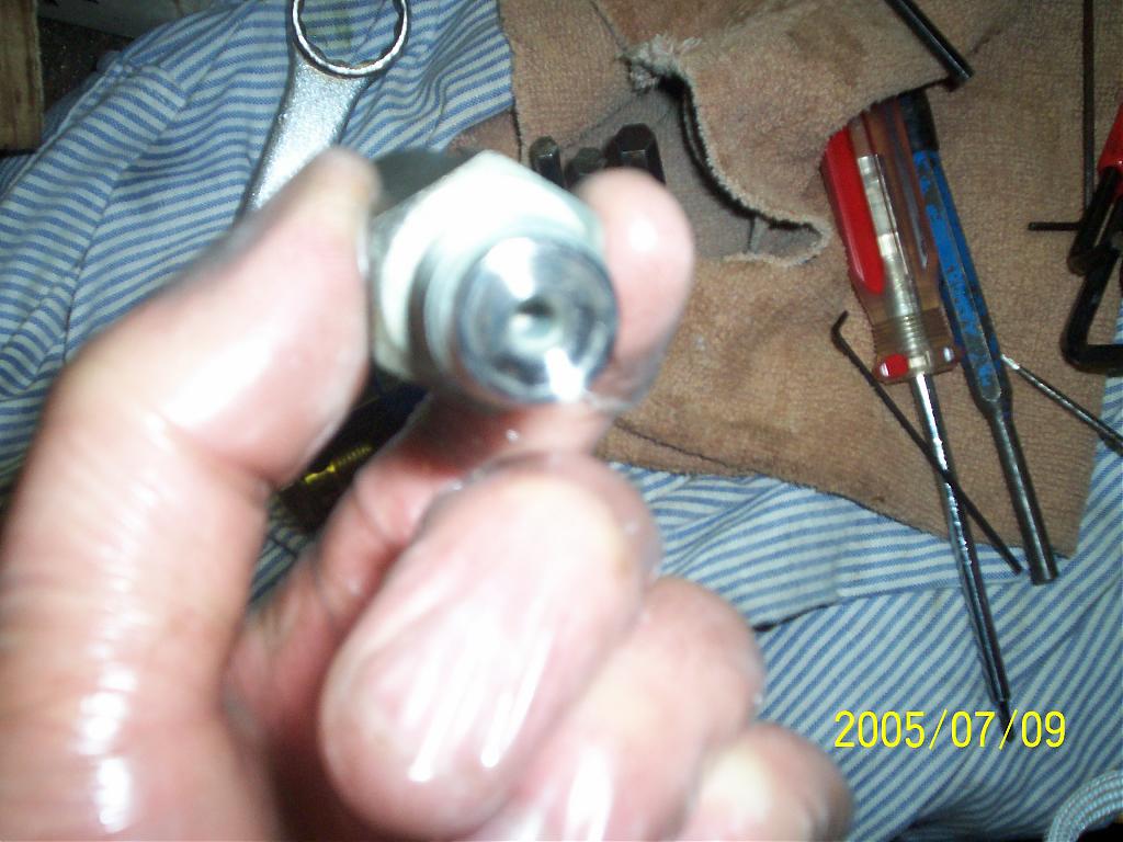

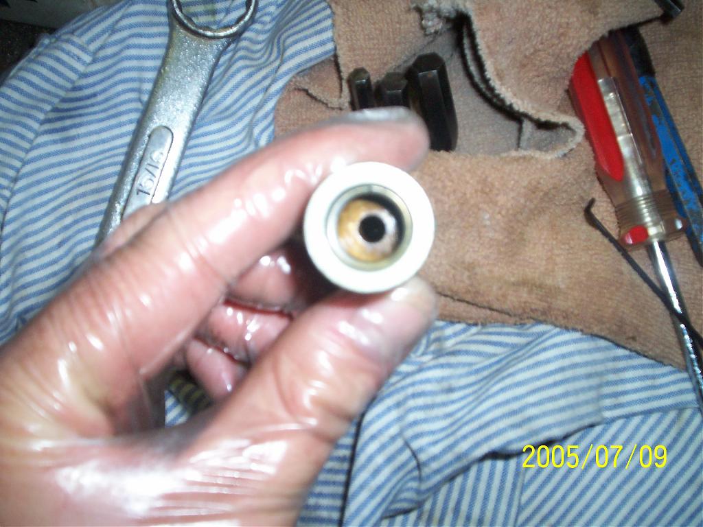

Okay so I took out the FCA took it apart, and cleaned it. It did not look too bad inside. It seemed to move in and out of the bore well. I took a few pics if anyone wants to see them. The only advice I would have on the FCA is that when you reassemble it, carefully put the little cap that holds the spring in there. It can easily go past its spot, as there is no machined stop for it.
Next, I took out the pressure relief valve, it looked quite dirty inside actually compared to everything else, I have no idea if it was working right or not, but I cleaned it anyhow because its easy to do. I noticed that when you look inside it, it looks as if it can be taken apart/adjusted, as there is a helicoil type thing in it, then an allen head spring stop inside. I took some pics.
Overall, I have no idea if it helped yet, I will find out tomorrow morning when I go to start it.

Moparman..........you have us all chomping at the bit. So you say your CR Pressure Relief Valve looked dirty inside? If it can be cleaned/rehabilitated, that's a $400 savings in itself!! Good work man......

That pressure relief valve I belief could be disassembled. I am not sure whats inside, but if you know how to remove helicoils, then you could take it apart. The helicoil stops the little spring stop inside from being removed which would then allow you to remove the internal parts. I don't know how you remove helicoils though.
What I should have done is seperately cleaned the FCA, then tried the truck, then, if that didn't work, tried the pressure relief valve, that way I would know which one that I cleaned helped the situation.
