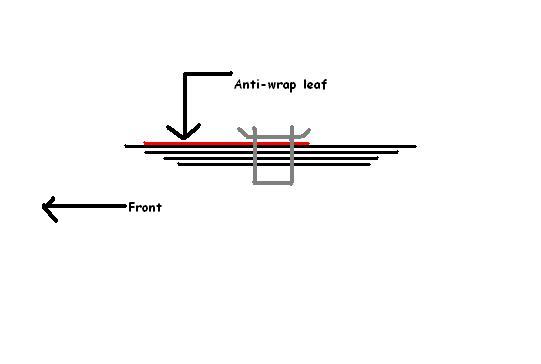

In rockcrawling some of the better leaf springs come with an anti-wrap leaf. It is half a leaf that is mounted on top of the spring pack. I runt hhem on my rig and do not get axle wrap. I run a fairly wide/big tire, and have a lot of torque do to the gearing in my T-cases, 207-1 in Lo-Lo-Lo.
Here is a crappy drawing of what I am talking about.

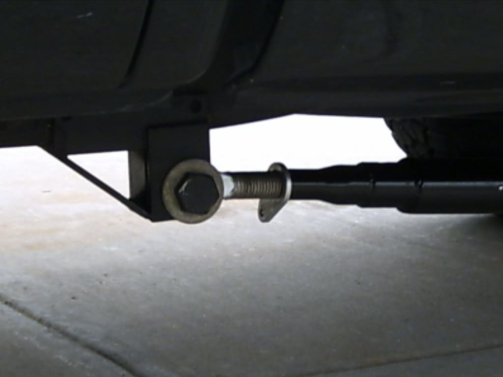

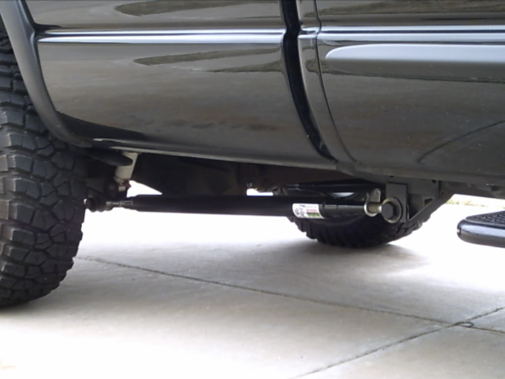

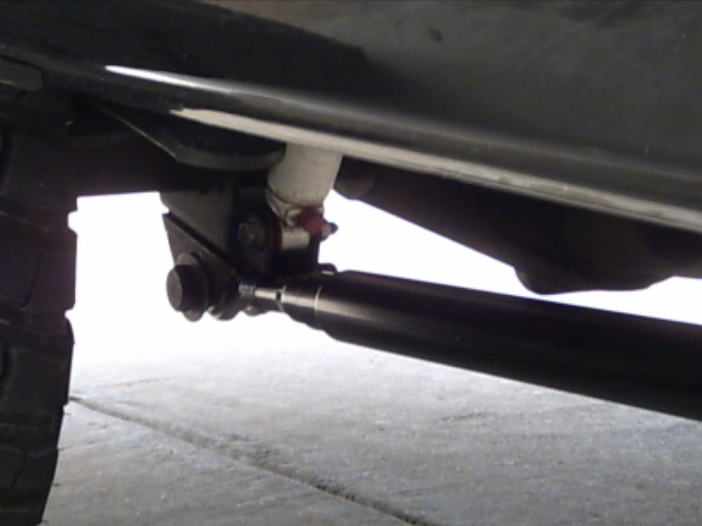

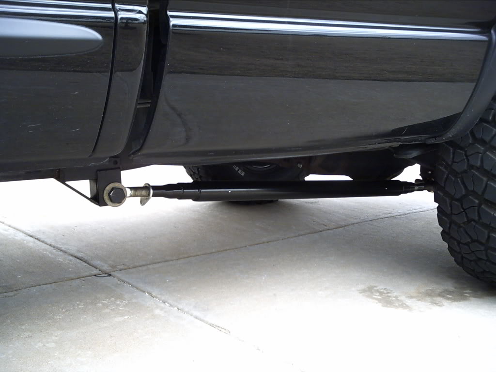

Give Mike with Lazarsmith a call. He makes some awesome traction bars. http://www.lazarsmith.com/tractionbars.html
Here are some pics of Lazar II's on my truck.....
Most serious rockcrawlers use a triangulated traction bar design with leaf spring setups. The anti-wrap leaf will on a light rig, but it won't eliminate the wrap on a heavy truck.

In the above pics are those two pieces of steel(don't have a bend to them like the leafs) under the rear leaf springs stock?
Mine has the same thing, but I thought they were not stock?
