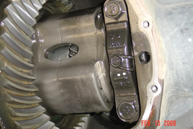

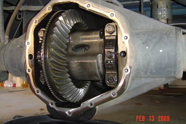

Well every thing looked normal. The oil and the inside of the case was clean.
I refilled it with GL5 80W90 dino oil that doesn't contain friction modifiers. The Mobil 1 I have been using contains friction modifiers for use in posi units that contain chutches.
Well see
Billy

It appears the Trac-rite is working better now. The additives in the oil can make a differance in the way the Trac-rite works. Too slick and it doesn't want to lock. This is a differant working differential than other types and doesn't work like the ones with clutches. It works like a open differential and if one tire spins too easily it doesn't load the differential enough to lock it up. Something we're going to have to live with. Anyway mines holding up well to 1250 lbs of tq "something it's probley not designed for" so I'm ok with it.
Billy
