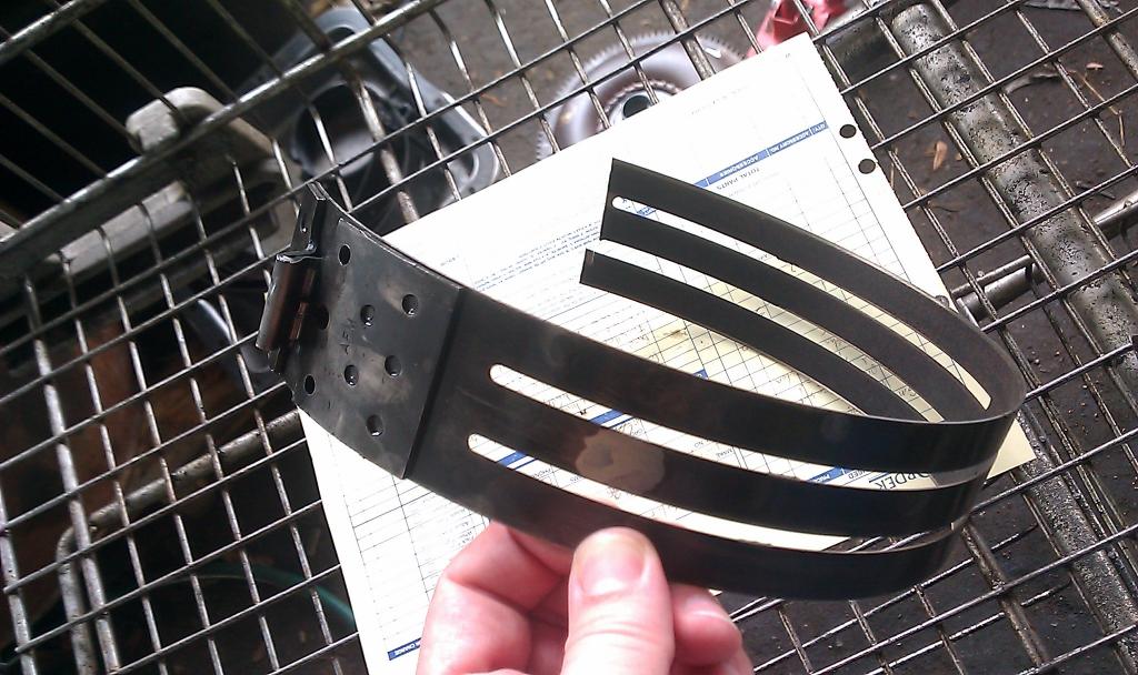

my band was down to the rivets
2006 dodge Heavy duty 48RE, took it in to change out the OEM sorry solenoid for the upgraded GM solenoid. was shifting sloppy. i had changed out the OEM solenoid years ago, and done a Fluid & filter few months ago (all myself)
https://www.dieseltruckresource.com/...x-t229203.html
my tranny guy recommended a band adjustment, and it needed it.
by the time he got it right, the adjuster bolt was about flush with the lock nut that holds it.
so he recommended dropping the valve body, and looking at it.
was very loose, and he knew how to fish a new band in & out without dropping the whole tranny, just from the area above the valve body.
fished out the old one, and it was down the rivets. a few more hundred miles, and i would have looking at a tranny rebuild, which most folks quote at $5k for these trucks.
and then, he recommended a bunch of "failure prone" upgrades while he had it apart.
it shifts & drives GREAT now. and he brought it in about half the cost I thought he would.

those aren't rivets, there are no rivets in that band just spot welds where the anchors are welded on, as for the cheap fix if your band looked that bad the front clutches won't be far behind, enjoy it while it last it won't be long.
