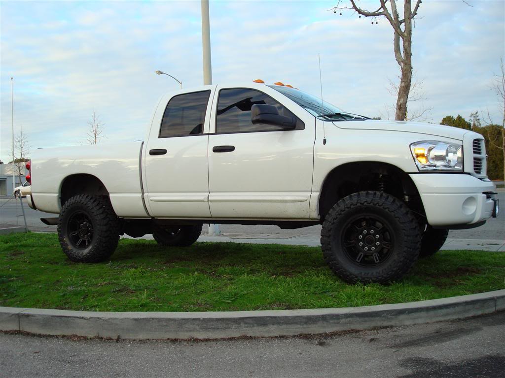

I have an '07 5.9 with 3.73's and 35's. I get a whole 12.25 miles per gallon. Motor, trans, etc COMPLETELY stock. Ha! Not used to that
Before the 35's I got 13-15 depending on driving. Best of 16.1. I don't think you'd be too far off from my current mileage. I'm sure if I drove in town more I'd be in the 11's.
Not bad though. I was at a Ford dealer yesterday picking up my flatbed, and the svc. manager told me I'd be lucky to see 8-9 mpg in the new 6.4!!!
