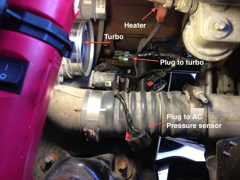

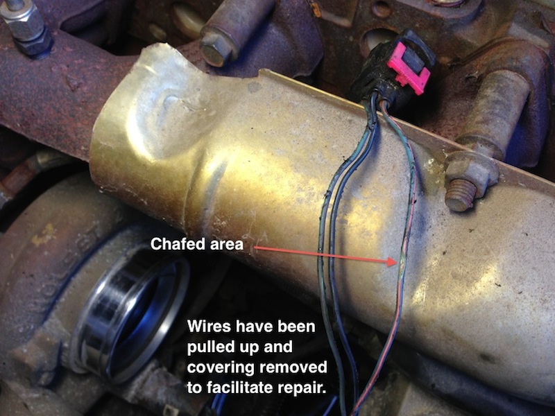

Yes, so I had the servo disconnected and was putting a new 5" turbo-back Flowmaster when what did my unbelieving eyes see but a chafed area of my wiring....
Impossible.
I had checked.
I had the shop check.
I have spent $1,000 and over a year fighting this thing. But it looked chafed in the right light.....
So today I changed the oil, pulled the filter, pulled the intake tube to the turbo and disconnected the harness to bring the wires up where I can see them.....
It was chafed through the jacket.
I cut the wire, stripped both ends back and put on a crimp on connector with heat shrink ends.
I reconnected the 4wd servo and the AC pressure switch wires...
Now we'll see if it give me fits still.
Impossible.
I had checked.
Please please please please please.....
