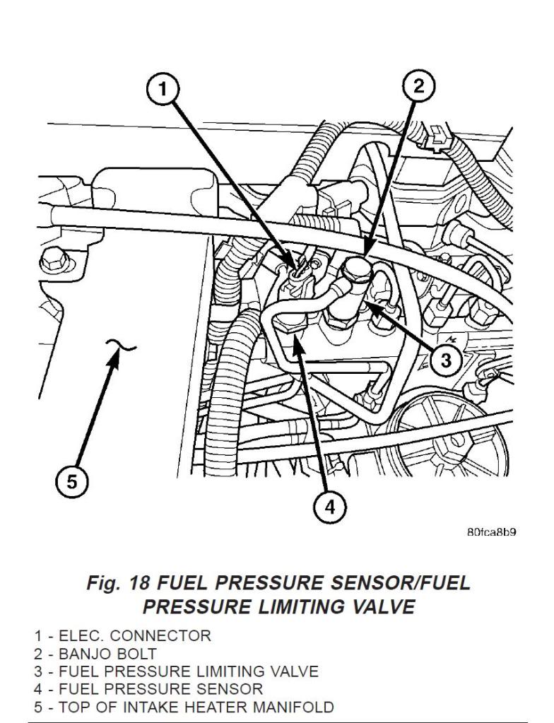

I have been looking around the forum , is there any pic of rail sensor and the prv ?

If the relief valve has blown it won't let the rail build any pressure.....no start!! Pull the banjo bolt off the top of the relief valve.....if fuel is present there that could be your problem!!! Not a definite solution but a place to start.

Ok , scanner reads pressure switch all over the place , I removed the return pressure line there is some fuel there ? so I removed the prv and pluged it at the manifold , and the rail sensor is all over the place in psi ? so where is a good place to get a rail pressure switch
