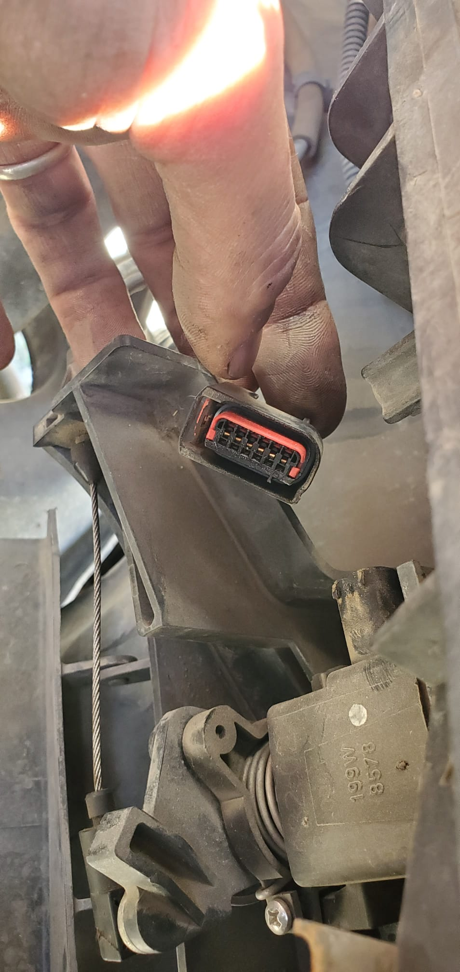

Hi all - i thought id ask on the diesel forums cos noone in the gas world even knows about these things.. my 2003 ram afaik uses the diesel APPS sensor under the battery box.. mine is a 5.7 4wd 2500 and just drives like a turd. 120k milies. 100k ago i replaced rings bearings plugs timing set and checked bores etc, motor was in gr8 shape.
TPS graph randomly spikes whether im driving or just sitting without engine running
This is my APPS connector under batt box

- I have verified the tps sensor output is correct according to Timbo APPS website (once again a DIESEL fix).. I have no drops visible in ohms or volts as I advances the throttle. See his link here: http://www.dodgecumminsapps.com/03-0...tery-APPS.html
