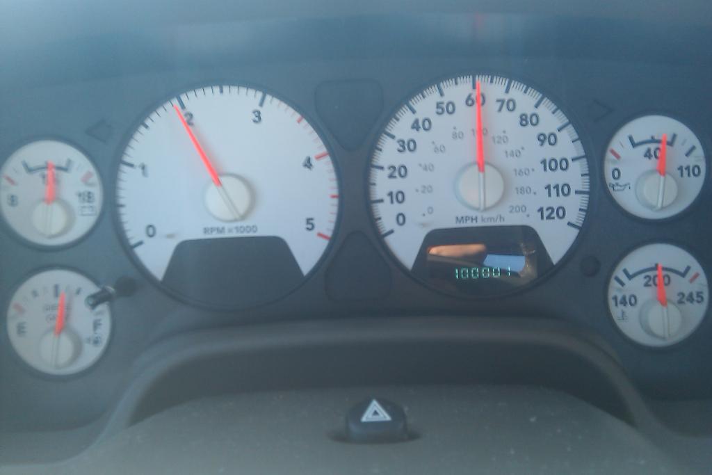

Um, I thought it had the 4.10. It turns around 2,500 at 70mph. I have driven similar trucks that at 70, the RPMs was down near 2000.
My truck turns 2000 just under 65mph.
I need to get the buildsheet from Dodge I guess.

here is a picture I took while on the Interstate as my truck crossed 100K miles a few months back. I was in 6th gear.
Is this inclusive of a 3.73 or a 4.10 rear?

You're right carl48. It's all in the details. Apparently the '04 manual I drove for a while, it's NV5600 is apparently geared much differently than my G56. I didn't know the trans and ratios changed.
I just found a calculator online and the RPMs I am seeing are indictive of a 3.73. Thanks!

Auto trans and 3.73 run 1950 RPM's at 70 MPH. IIRC six speed with 3.73 run about 2100-2150 at 70 MPH, your photo shows 1900 at 60 MPH, 4:10's?

4.10's aren't even an option on a G56 truck. There were a few that slipped thru in 08?, but there was a warranty recall on them.
That is what I thought so too originally, but as I am finding out, the G56 tranny is tricking me to believe such. If it wasn't for the tranny, the RPMs would match up against the MPH for a 4.10 rear.
