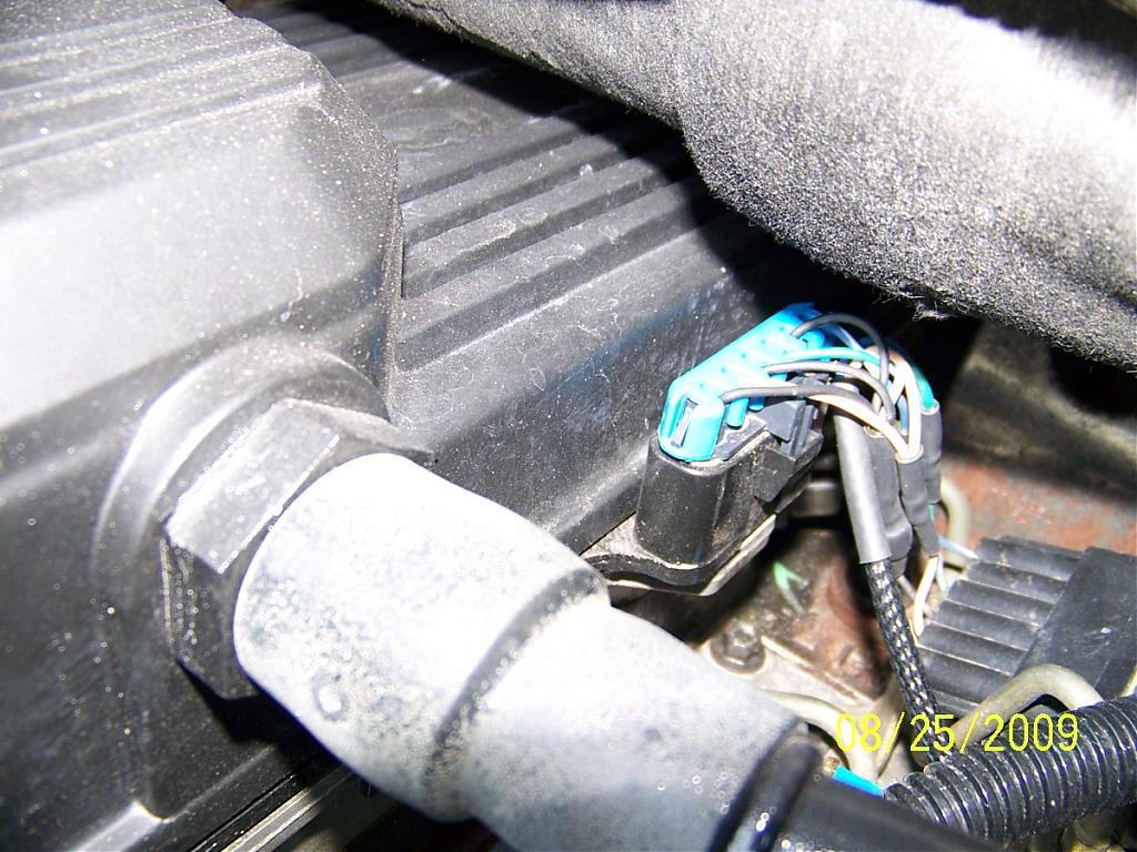

If you had the computer controller wiring off for any reason, its possible you may have bent a pin putting the harness back on the pins. Picture is a Edge Harness. Shows what I'm talking about.
Dave
An 03 Does not have that connector there. The injector harness is quite a bit different.
Old Nov 20, 2009 | 07:56 PM
CoastalDav's Avatar
Posts: 1,425
From: Melbourne, Florida
Sorry bout that. I figured they were the same. Learn something new every day.
