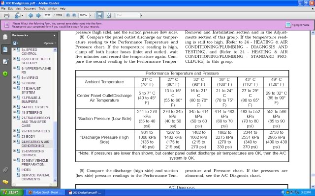

You might be too low. I just had an issue with my a/c system with rapid cycling. My low side switch was cutting out at 35psi. I found the dealers manual online and posted it here in forum. It does have a chart that you have to use. I'll pull in the chart for ya. Most of you will be pretty surprised where the pressures should be. But my a/c fogs up windows now. But once you have confirmed your pressures are as close as you can get them, then we can start trouble shooting. Keep in mind that the high and low side can vary big time because of the ambient air temps in the cab and outside. Keep this in mind because if your truck has been baking in the sun all day, your pressure will be through the roof and all over the place. Once the cab starts cooling down and the truck warms up and kicks the cooling fan in, you will be able to get a more proper reading.
Hope this helps!
Woops! Sorry it's so small, I found the download link for the manual. Here ya go! http://www.rm-indy.com/wavefiles/2001ramsrvcmanual.zip
Ps: Your high side may be low because your cooling it down with water, the cooler the condenser is, the lower the pressure is going to drop. But it could be a defective gauge as well like bgflatbed said.
