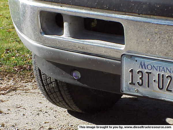

Originally Posted by infidel
I used the OEM switch for fogs on my '95. No special plug, just used female crimp-on spade connectors. I grabbed the power for the dimming indicator light off of the OD switch. Only other wires needed were ground, two positives (one for the on indicator light, the other for the switched +) and one switched + out. After searching for the underdash end of the wiring harness for a couple hours just ended up running one wire from the switch to a relay mounted on the battery holder. Supplied positive to the relay with a inline fused wire right to the battery. New wire to the lamps themselves.
I used 80 watt projector style lamps peaking out of the lower bumper skirt. I chose this style after walking though a parking lot and noticing that most of the low hanging fog lights were cracked. The projectors have a lens over an inch thick.
Set up works great.
Pardon all the Montana bugs
