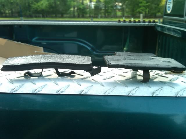

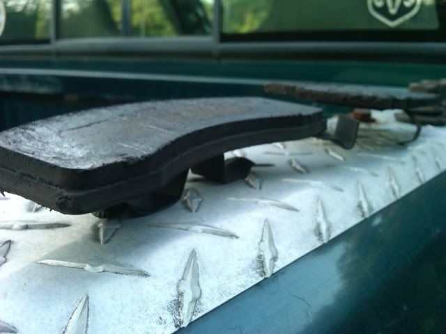

Uneven brake pad wear
Old Apr 24, 2011 | 01:56 PM
dieselfuelonly's Avatar
DTR question asker
Posts: 869
From: Chapel Hill, NC
Ideas?
Old Apr 24, 2011 | 02:50 PM
blackimpala's Avatar
Posts: 634
That happened to mine. Greased the slide pads and pins, all was well.

Old Apr 24, 2011 | 09:49 PM
Silver R/T's Avatar
Joined: Oct 2008
Posts: 944
From: Spokane, WA
sliders are sticking, common thing to see when someone just slaps brake pads on their car and doesn't pay attention to the rest of brake system

Old Apr 24, 2011 | 10:36 PM
Robert Rausch's Avatar
Joined: Jun 2002
Posts: 1,125
Likes: 20
From: Missouri
When mine first wore badly on one side I did some trouble shooting and figured out I hadn't greased the sliding pins on that set when I put the pads in. I've installed 3 or 4 sets of pads since then and have never had them wear too much unevenly. So for me, greasing the sliding pins was the answer.
Old May 1, 2011 | 02:32 PM
SIXSLUG's Avatar
Posts: 5,614
Likes: 167
I just had to R/R my right rear caliper because one of the pistons froze up....smoked the pads and caused them to wear at an angle.
Remember when compressing the caliper pistons, they should retract with little effort. If not , you may have a corroded piston.
Old May 1, 2011 | 02:37 PM
Purplezr2's Avatar
Posts: 1,290
From: MN
Originally Posted by johnh
normal, one side will always wear more than the other
I disagree, well alittle is normal, it looks like the ones side has alot of pad left and the other side is down to the rivets. I woulds say stick slide pins is the issue.
