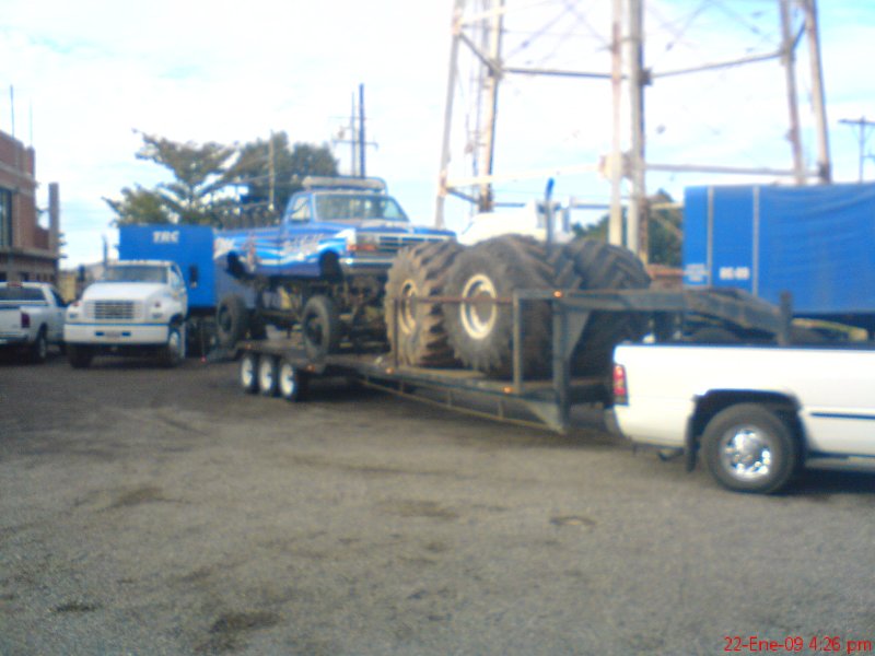

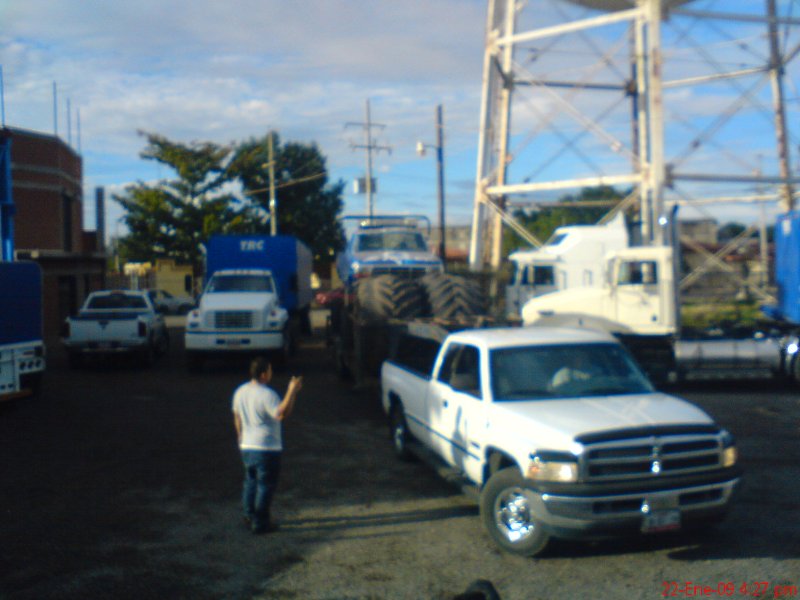

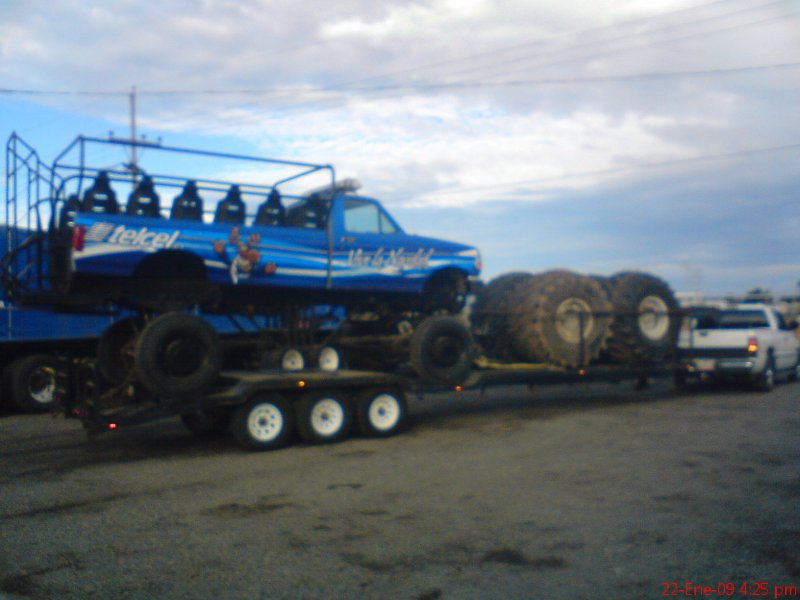

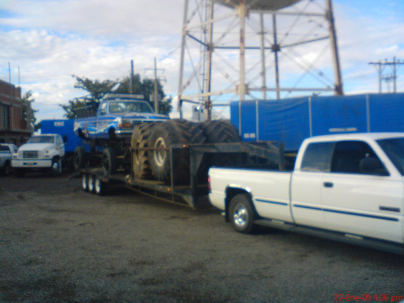

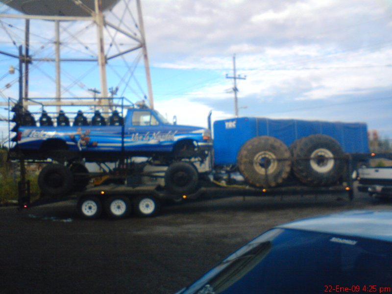

Hi everyone, I have a 1999 Dodge 2500 5.9L 24v STOCK POWER
Im towing a long and weavy trailer; 20,840 pounds (just trailer loaded)
Im towing a MONSTER RIDE TRUCK with tires on a 33' long trailer, 3 axles with 2 of those axles with brakes (thinking to add brakes to the 3rd axle).
Do you think that my Diesel Truck is capable to tow my trailer with no problems in the future? transmission issues maybe? DO I need to upgrade my transmission??
Also how much power can I add (or do I need?) to tow my trailer easier?? 40hp?? 80hp?? 150hp?? torque? 100? 200??
Im thinking to buy a Edge juice with attitude. Is this ok?
Right now, I feel that my truck start towing slow but as soon as get speed, feels ok.
Can some one of you guys have experience before or something similar can help me with this questions?
Sorry Im new on this and I dont have experience.
THANKS

Looking at the squat in the rear I'd be thinking about a 3500 before I spent any money on upgrades. It looks like you're pushing the rears and you're also getting into CDL territory.

Your going to have some real problems with the rear end. You really need a 3500 series truck mininum. BUT, if your going to keep the truck. Your first need is better diff cover to handle more gear oil and some air bags. What trans do you have, auto or manual?

I would agree you might just need a bigger truck. Maybe even bigger than a 3500, 20,840 pounds is up around dodge 5500 or ford F-650 heavy. I do believe the trailer is heavy enough and if you are making a profit with the ride truck that you need a CDL.

Looks like you could also remove some weight from the rear end of the tow rig by backing the monster truck onto trailer. That will put the engine behind the axles of the trailer and will reduce the pin weight on the tow rig.

Im towing (pulling) 20840 pounds but Im carring on the goose neck on the bed 3800 pounds, I can load the truck backward, in that way I can have the engine on the back of the axles helping with the weight.
is this correct?
