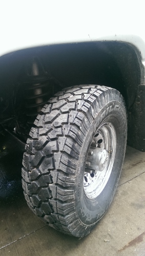

I talked with my local tire shop that I've dealt with for forever and they said I didn't need the wider rim. I have noticed these rub just a bit (20/32's of tread) so I will be getting a leveling kit so I don't tear up mud flaps and the body with chains in the winter. Weighed the tires and came up with 96 pounds, but I have steelies. I'll find out tomorrow on mileage and power loss. Here's hoping.
