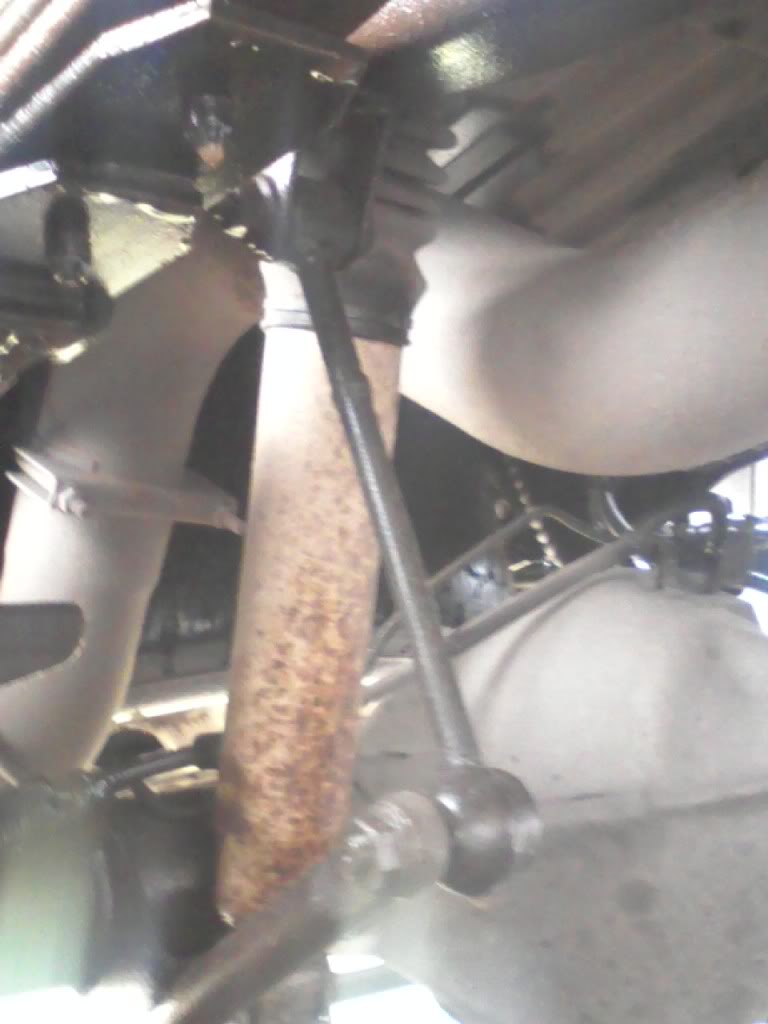

I made mine from a 96 dodge carivan, basically cut one in 1/2 and welded the truck end on one side and the Van end on the other, cost me 50$ to make 4 of them, best part is they are greaseable!!, I have an 01 and I believe they are mounted different on the older trucks although it should still work...somehow
the front:
The rear:

I'd argue on how long they last, mine have at least 40,000miles on them, they are still tight, and even if they failed it only cost me 25$ for two.(I believe they were XRF brand) and that 40,000miles was done at 8-10hrs a day for the past yr,
I do run carli springs but thought the links were too expensive, so I made my own
