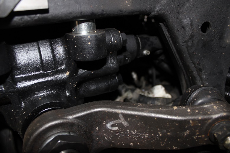

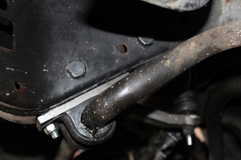

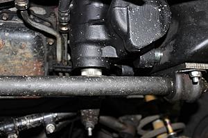

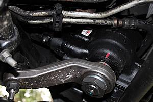

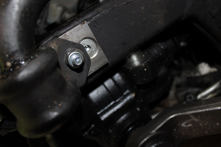

Ok guys, here it is! The final results of the PSC SG852 steering box. First impressions........... the steering wheel is much tighter and I am not finding myself sawing the steering wheel back and forth on the road. There is still just slightly some play in the wheel. I honestly think that is because I still have the OEM style track bar on the truck. I also have not installed the DOR steering brace for the new box yet. Turns out, I confirmed that the sector shaft extension nut is the only difference between the 2 PSC braces offered by DOR. They simply said to send back the 1.25" size sector shaft extension nut and it would be swapped for the 1.75" (which is what is required for the SG852). I am really happy that this steering installation fiasco is coming to an end. I drove the pickup 340 miles over the weekend and enjoyed not having to corral the truck inside my lane. The turning radius ability in parking lots is great, no issues there. Note: I am running the stock power steering pump with no issues. I attached some pictures of it installed. Hope these help others prepare for what they need and clears any confusion on the installation process.
