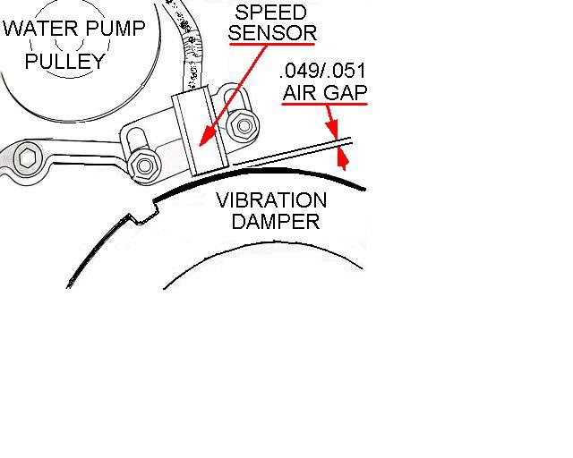

If the engine speed sensor isn't operating correctly it tells the computer that the engine isn't running, most everything electronic won't work. Make sure the connector is clean, the gap is correct and the wires are intact.

12 valves don't have a CPS, that's a 24 valve thing.
Many times the ESS is mistakenly called a CPS.
