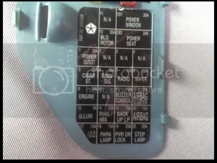

Need list of fuse assignments and fuse sizes.
HELP I need a diagram or list of the fuse assignments and strength of the fuses. BTW This is for the cabin fuse panel on a 97 Ram 2500 5.9 the panel cover is missing.

Tks
Thank you, this will do the trick I printed,laminated cut, and paster on newdoor.
