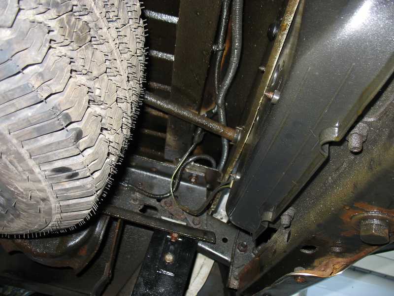

Checked things out. Attached to the spare tire pulley is a round pipe held on by a pin, at the other end of which is the hex opening that is located just under the (closed) tailgate, in which the matching hex pipe fits in and allows turning the pulley from the outside. That round pipe could be disconnected and shortened, leaving the hex end underneath the truck (secured somehow), into which a proper hex socket could fit in and be used to lower the tire with a ratchet. That's the only way I see this working.

^^ this is what I was going to suggest

I done this, turned the tube from underneath with a small pipe wrench, A good set of channel locks would work also. It is not hard to turn after the initial 1st turn.

Yeah, I figured the tire could be lowered like this, but to get it back up may be another matter altogether, which is where a ratchet with pipe extension may provide enough leverage to lift the weight of the tire. Unless of course, I just throw the bum tire in the back of the camper until I get to a service station...

I just carry an 8" pipe wrench and use it to turn the shaft between the bumper and spare.
Have to lay under the truck to do it but it lowers and raises the spare just fine.
