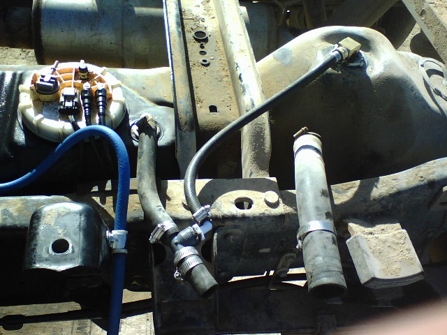

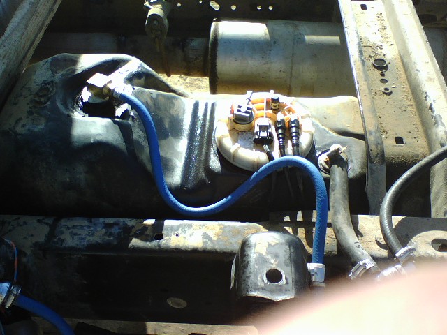

Well guys, thanks for all of your help, AGAIN!!! I went ahead and just pulled the bed off. I was by my self and figured if it was on the ground, it would be less likely to smack me in the back of the head!!! Or at least more difficult. Fuel sender turned out to be okay, at least it tested out okay, But my draw straw was leaking so I built a new and decided while I was in there to do the tank vent mod at the same time. Clamped my supply hose from the tank to the FASS to the frame so when I change the in line filter it doesn't yank on the draw straw.

Thumper, glad you said that, I decided to look over my exhaust system and found a couple of pin holes on the joints that the welder missed. I just filled em with JB.
Only question I have at this point is if it is okay to put a hose and in line filter on the grey vent on top of the fuel canister???
Posted some pics if your interested. Kind of a novice mod, but hey you have to start somewhere right!!!!
