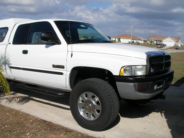

The Curt is a high quality unit. It installs pretty easily and is solid. The only minor gripe is that the unit sits lower than I'd like. There's about a 2" gap between the top of the hitch and bottom of the bumper. I put some NorthernTool cheapo driving lights there to make lemonade out of my lemons. Looks cool and works well. I got it from JCWhitney.com (284436) for $176 plus shipping. Here's a pic:

hey Sheriff, how do those hummer rims work for you? you happy with them? need anything to make them work?
Nice truck, looks like mine!!

I love the '06 Alcoas (called the LTS-8 Spoke in aftermarket speak). I got them for $400 on e-bay. What's great is the original Hummer caps fit on these wheels on our trucks. That was a bonus....
