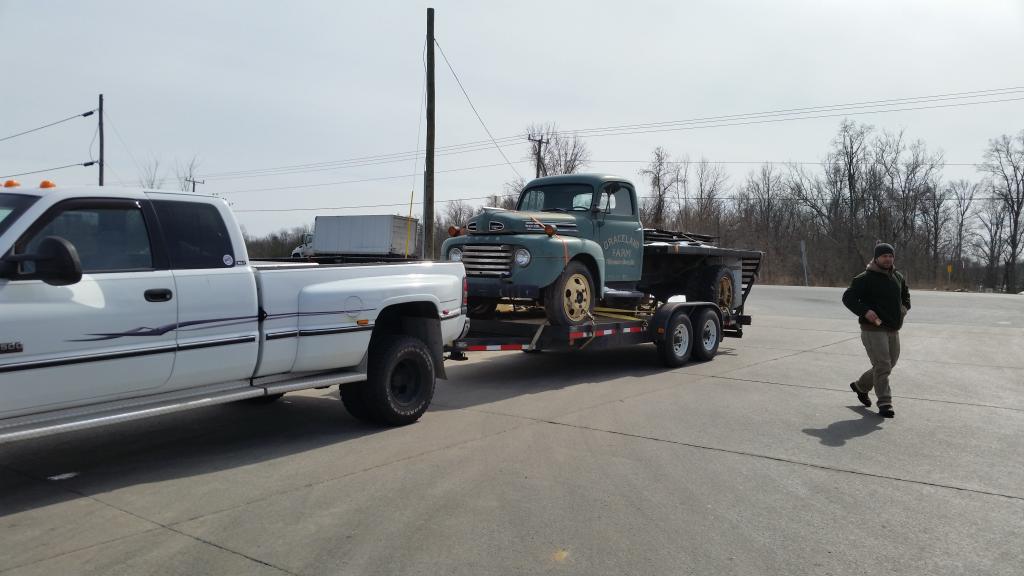

Have not gotten it into the shop to realign/check caster (I still plan to).
200 miles this weekend.
100 pulling this old thing (not mine).
Rough roads in Maryland.
No wabbles.
Not much hitch weight, but not negative.
Just sharing.

Old May 5, 2015 | 08:56 AM
macattack_ga's Avatar
Posts: 269
From: Fairfax, VA
Back from the 1200mile trip.
No wobbles.
I did replace the front tires 350 miles into the trip. One was cupping/uneven wear, the other had some broken belts. Tires were old, but still had 1/2 tread. It was a rough first 350 miles, but smoothed out nicely with new tires.
I'm still planning on re-installing the steering dampener (the shock, not the reinforcing steering box brace), but it shouldn't be much trouble to reinstall with a larger U-bolt.
