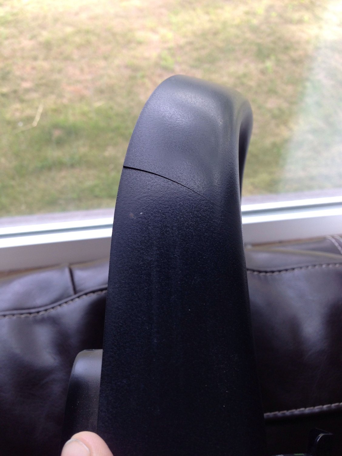

Here's the crack in mine , I have it off ready to repair. Should I use JB epoxy? JB weld ? Drill a few small holes on each side ( so it can bond in one piece ) and fill it in top<br/>And bottom with JB and sand and touch up with black paint ? I'm open to try anything

I'd back it with a small strip of abs or suitable material so it spreads the tension out a little....
My dash is getting pretty bad, but my bezel is still good.
Sanding it will alter the texture, don't know if that bothers you or not......
