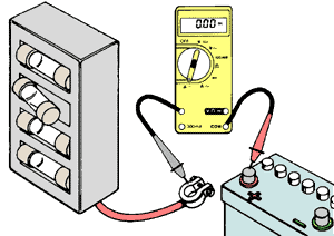

Another thing you can do is hook up a meter in ampere position as shown below and start pulling fuses one at a time to isolate the problem.

That is what I did and found that it was the computer. I am just unplugging the computer not when the truck is parked until I figure out which wire to put the switch on.
