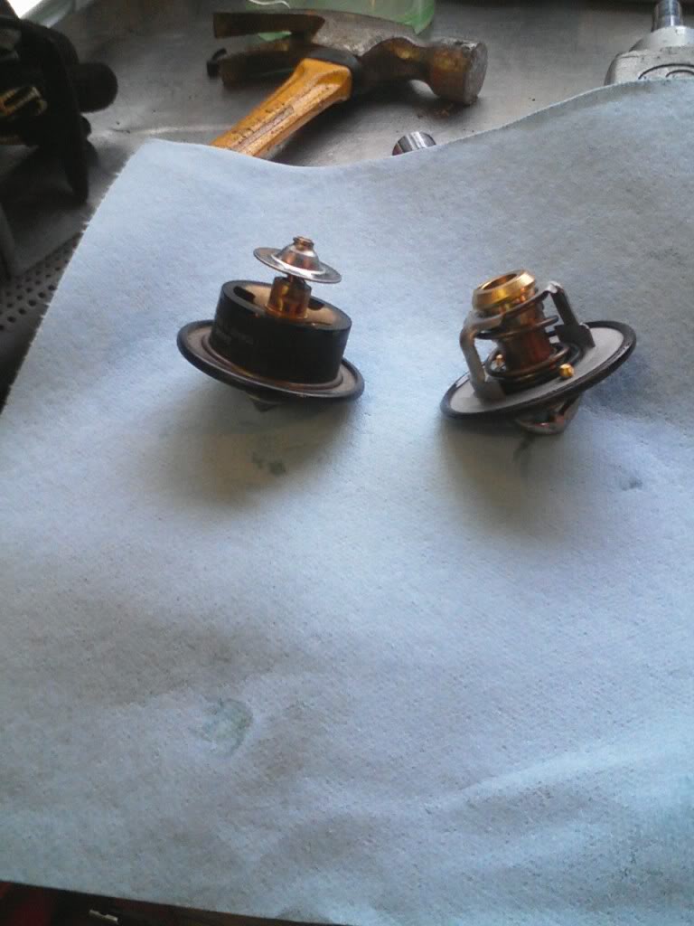

wrong type of thermostat will do the same thing, or more likely heater core is plugged,
as for thermos the Stant on the right would get to 190* on the gauge but would not direct enough coolant thru the heater core, the OEM stat from cummins fluxiates more 180-190, but makes a huge difference in heater output. I tested mine the other day and idling at 1200RPM and engine at 185* I get 41-42* C at the drv side heater vent,
have noticed I dont seem to get any noticable heat until engine temp is over 140*F..
I have an after market heater core, and I believe its not of the best designed

Did replace the stat with a napa one about 5 years ago. The factory one had become inoperational and I couldn't get any engine heat at all. Replaced it and everything seemed good, at the time it didn't seem to affect the heat in the cab. I guess the thing that puzzles me is that the hoses in to, and out of the core are hot. Guess I start with either buying a scope or replacing the stat. Getting tied of being cold. Gonna have to start running my camping stove in the thing if I can't get this rectified,not .

I just replaced my thermostat with one from genosgarage.com and I get *much* better heat now, and far sooner than before.
