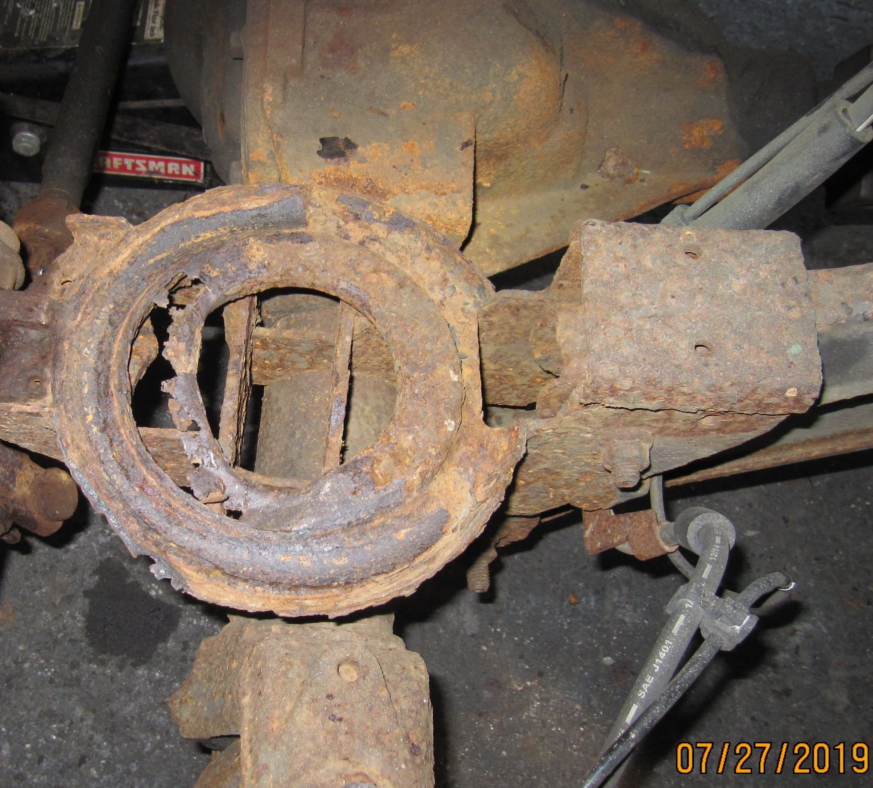

Its been a tuff 8 months of this year for Me and My truck already, ( I cant believe 8 months into the year already), My transmission has been making noise for 2 years now and grinding when going into 3rd gear so I've been double clutching 3rd for 2 years now, I'm finding that's a Hard Habit to break , Clutch chattering so bad it would shake your teeth loose , I would just take off in first gear just to get the truck rolling for second gear,, So the end of March I went and pulled the transmission out to rebuild it,, That's when I saw the frame rot just behind where the trans skid plate bolt onto the frame, With fixing that and ordering transmission parts it took a couple, OK 3 1/2 months, of course the weather did not cooperate either, My OPEN AIR Garage (driveway) does not like the 40 days of rain we had in the North East , Then in the process of that I see my coil spring perch's do not look to good, I Need to get a few more years out of my truck before I can afford another one, SO I Need to replace them.

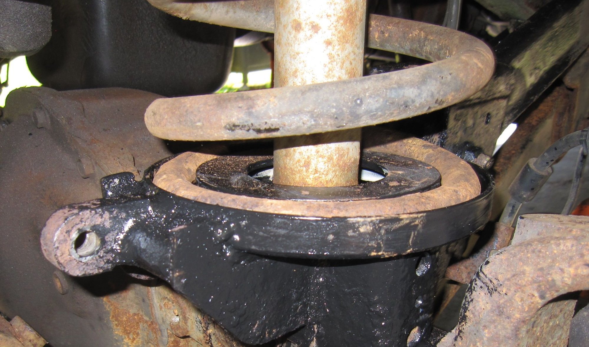

Ready to cut out

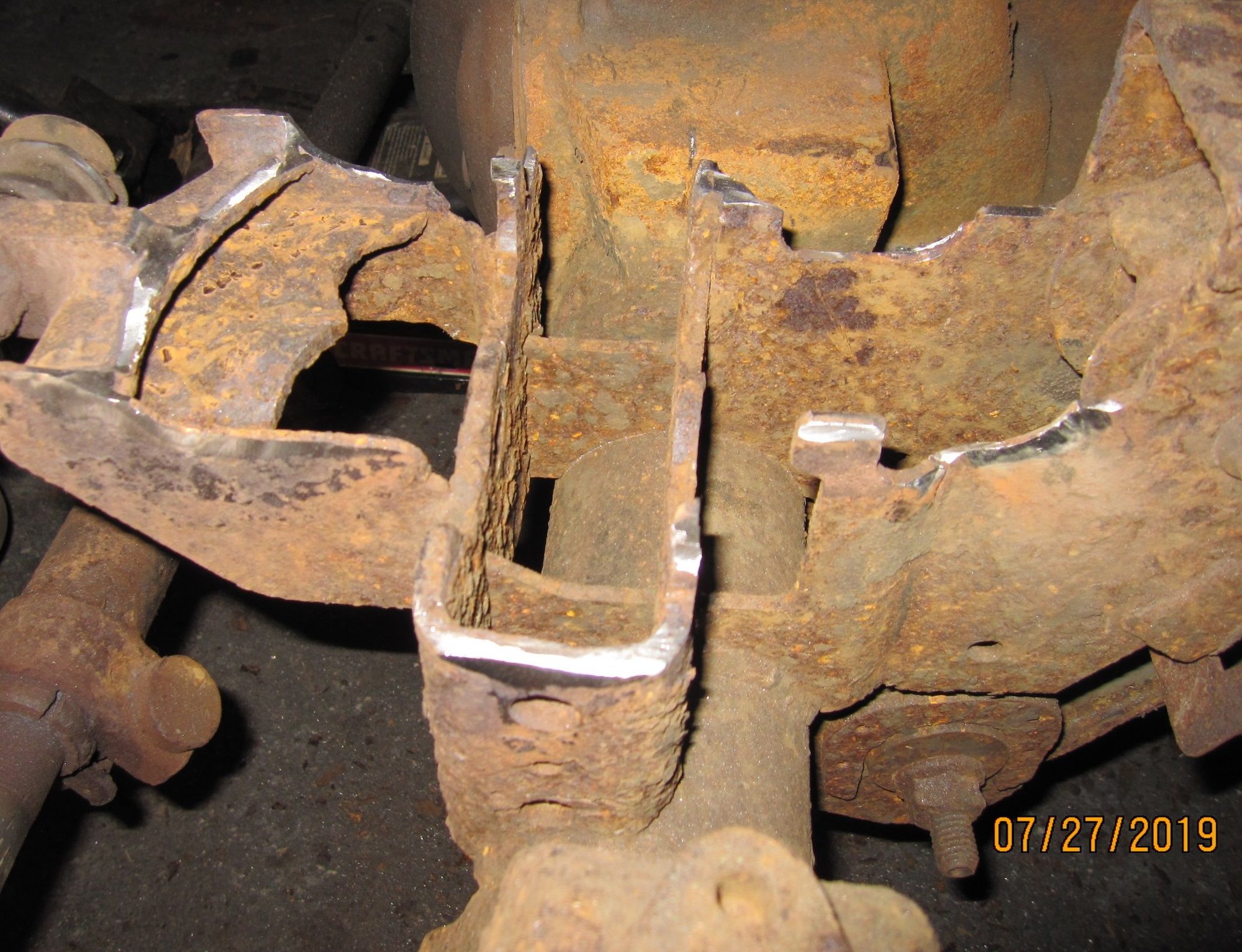

Old one removed ready to fit the new one
Fitted ready for paint and weld

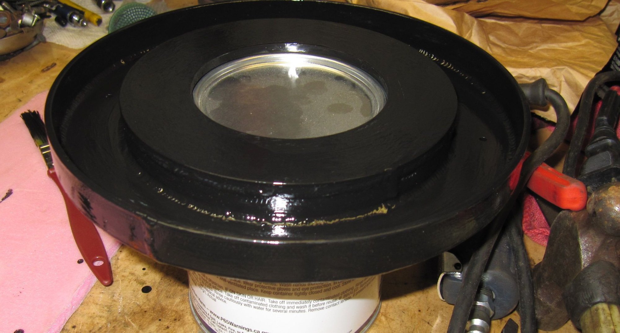

Painted Ready for install
Driver side welded in Ready for final paint
Passengers side, Start of the day.
Passenger side Done, With new sway bar links.
Start of Frame Repair.
Frame fixed ready for stress test.

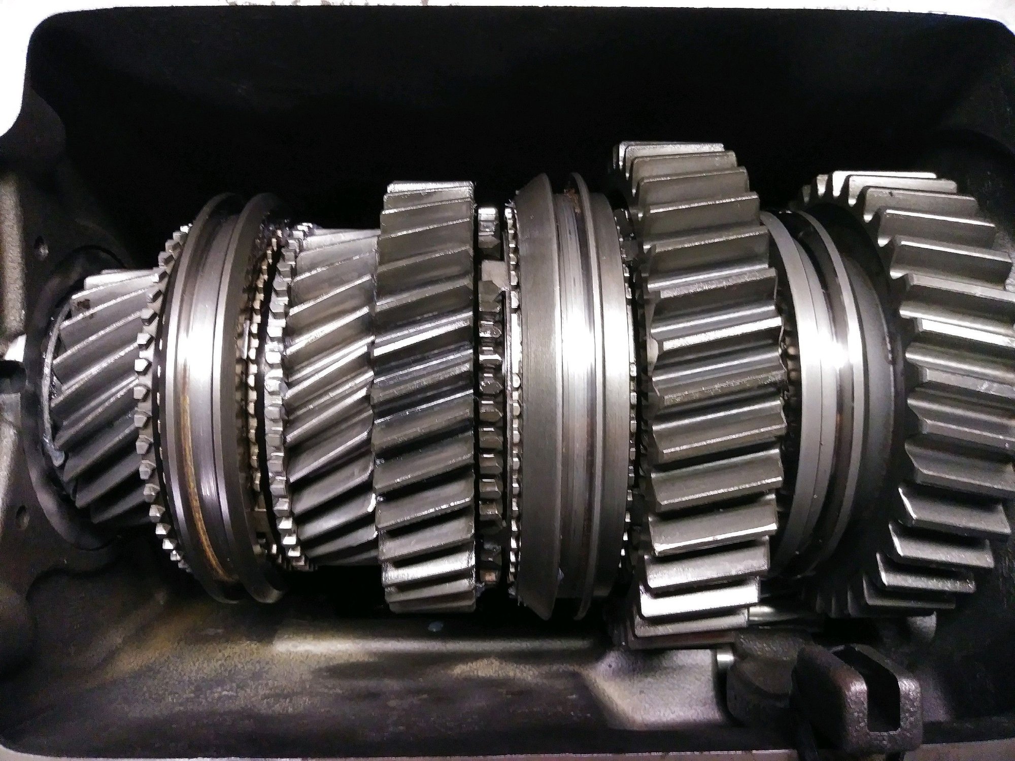

NV4500 Rebuilt ready for cover then Install in truck

Wow, that's some serious rust! I guess you must get a lot of road salt in your area?
I love the look of those spring perches. They look good and beefy. What did you find in your transmission rebuild--just synchros? The gears look pretty good, but I wouldn't know the first thing about rebuilding a manual transmission.

I would welcome Road salt,, They use liquid here, Like calcium chloride or something like that, You can see the white lines it leaves on the roads and you really hate to drive on it, Not much you can do.

As far as trans, 1600 miles and counting, its amazing how the miles add up so quick. Short cut to that post below.

That looks like salt water damage! A friend on the Rez drives his truck on the beaches to collect his gear and it looks similar underneath, but its a 70's Ford. Those perches look like good ones....
Those fresh blocker rings will help smooth things out, too!

I not a expert on replacing these buckets . Mine were no where this bad . My truck has not been in the Salt as far as I know . The front axle I got out of a 2001 4x4 had a bit of rust in the area where the spring sits . . So I decided to just replace them with these pieces. So after I got the axle up in some pipe stands and I used 2 inch pipe slid up in the axle housing . S I can rotate the axle and not have it on my foot . I used a long level across the spring buckets and the flat center of the buckets are not level with each other . So I finally leveled each side individually and cut out and welded in . I contacted the builder of the buckets and he also mentioned he was aware of this . I cut out the original buckets with a Metabo and a gringer to get a decent fit up . I used 7018 to weld in
