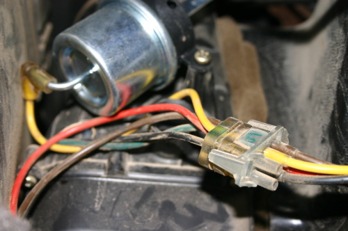

If you get air at the floor when dialed as such, you probably lost your vacuum solenoid for the dash vents. There was a recall on the 96's because the vacuum pump would let oil get into the vacuum lines, which slowly deteriorates the rubber diaphram in all the vacuum solenoids.
http://dodgeram.info/tsb/recalls/720.htm
It is under the dash in the center of the dash. You access it be going under on the driver's side and looking up, towards the right. It will have a yellow vacuum hose connected to it.
See pics.
If yours is like mine, the Dodge PN is: 4720279AB

That does not guarantee that the vacuum actuator isn't bad. You can test it yourself. Pull the vacuum line off the actuator then push the rod all the way into the actuator. Put your finger over the vacuum port and release the rod, if it comes all the wat out, the actuator is bad. It will come out a little even if the actuator is good, but I am talking about all the way.
