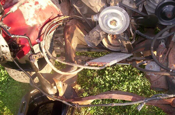

I remember it giving me problems when I tried to thread it in, so I used the 3/4" impact on it & snapped it.
Its' REALLY stuck in there.
For the record I'm really not into grinding off frames or welding unless its' absolutely necessary & there's really no other way out.
After I posted I thought of welding the front part of the sway bar bracket on as the only time that part would be removed is to change a sway bar bushing...& thats' not too often (if ever).
I'll try drilling it, but, I'm about 0 for 3 using easy outs, etc.
The whole front frame sections, basically from the shock forward on the passenger side & the steering box forward on the driver's side has been replaced & re-welded on anyways; maybe it'll match!
