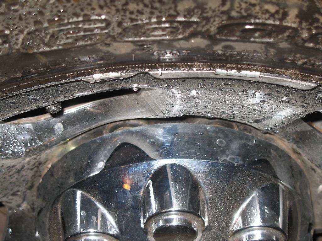

I'll take a picture of my axle and see if it looks like yours, because there is no way that it is going to fit without "some" modifications, are there two different caps? if so anyone know part numbers? I'll get the number from the ones I have too, see if they match yours thanks.

part number on my center cap is 52121450AA anyone know if there is another number maybe? perhaps a deeper cap, I don't know just wondering why someone with the same truck wouldn't have this problem

Is that a steel wheel with the chrome clad? I just put my 05 wheels on my 01 this week and had no probs. I do have that gap if i try to put my 01 centers on the 05 wheels though. Mine are the polished aluminum wheels like the pict above.

after some research I think they are from an '03, they look just like these
http://cgi.ebay.com/ebaymotors/OEM-D...spagenameZWDVW
there is a gap with the cap on, I'm afraid since the clips aren't fully behind the lugs they will fly off while I'm driving.

Well it's still abovo 60 degrees here so I risked hypothermia and went out and found from the wheel flange (smooth area between the lug nuts) to the end of the axle (area between axle retaining bolts) I get about 1.5 inches on mine. Looking at your pict you seem to have way more than that. Are they steel wheels with the chrome cladding? I'm thinking the 2500/3500sw were all aluminum wheels, and only the 1500 had the steel/chrome cladding.

well looking here I see there is a steel/chrome clad wheel. I'm thinking the center flange has to be thinner than the alloy wheels so perhaps there is a different center cap??? Guess most I've noticed (work on them daily) were of the alloy sorts.

I was thinking about maybe putting spacers behind the wheel, maybe 1/4" to 1/2" and see if it will go all the way on, will probably make the tires stick out a little bit, but thats okay, should be easier than trying to grind out the cap.
