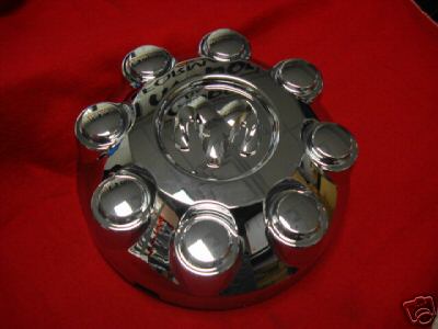

The caps fit fine on the front. I've attached a picture of my rear wheel and the style cap I am trying to put on it.

I have the same issue with my center caps with my H2 wheels. Been like that for two years, haven't lost one yet. I'm wondering if they changed the rear axle hub in later years, seems its the earlier trucks that have this issue.
