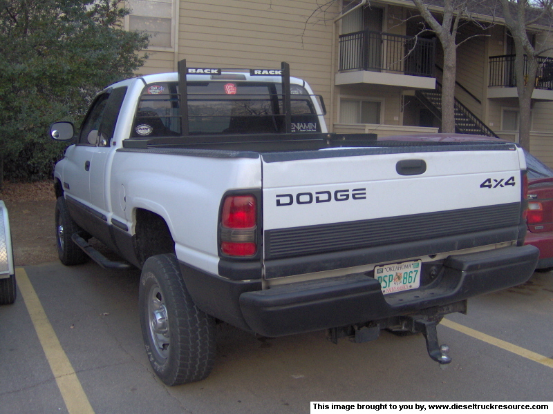

Starting in 98 you could get a 2500 in a short bed. You might be better off trying to find one, instead of swapping. You would have to probally beef up the frame some, and a stronger front axle, probally swap out the rear as well so the bolt patterns would be the same...
Here is the shortbed I had.
