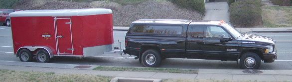

I have a Goerend Valvebody and Torque Converter in my '99 so my temps tend to run a little warmer in traffic.
My temp sensor is in a stock HOT line w/ fitting before the Heat Exchanger.
I pulled my 12 foot V-Nose trailer loaded with 6,000 pounds of landscaping stones 140 miles at ~60 mph yesterday in 40ish degree temps.
Tranny temps at highway speeds didn't register on my 140* gauge.
Once off the highway on secondary streets with traffic lights, I got up to ~200*.
Past the traffic and back to 50ish MPH, back to <140*.
Driving back pulling an empty trailer, temp gauge never moved above 140*.
In summer heavy traffic with the AC on, I have seen temps in the 260 range.
I don't let them get that high without dropping into Neutral and apply a few revs when possible to get the temps back down.
