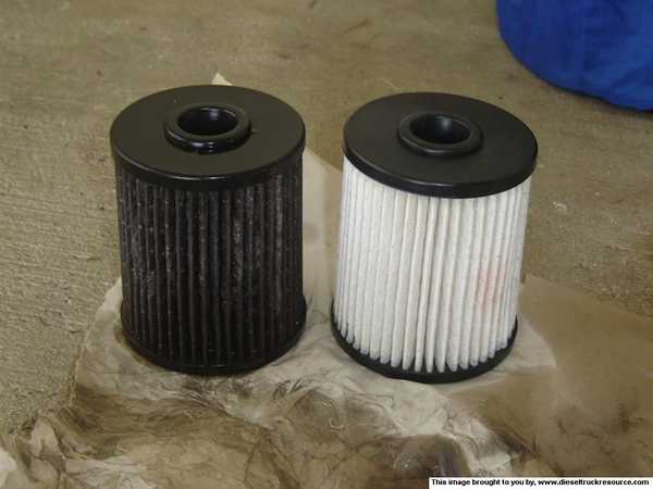

Heres my last filter at ~10K:

mine look same as JR.
i change them whenever, prolly 10k~15k or so.

Well it seems that y'all have some really eeeevil diesel. I change my fuel filter every 80 000 kms (approx. 50 k miles) and it's nowhere near as dirty as the one jrs_dodge_diesel showed. I do not see a difference in the fuel pressure between before and after changing the filter.
