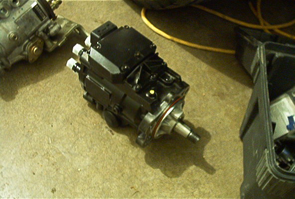

I turned the motor over and lined it up with tdc.
turned the fan a little put a puller on it and moved the fuel lines and she came out real nice.
the key fell off at the last second and almost went down.
I really appreciate the help from you guys,
Ive been working on it off and on for about 5 hours, I get distracted very easily.
Attached Thumbnails VP44 install Q?-im001864.jpg   VP44 install Q?-im001862.jpg
