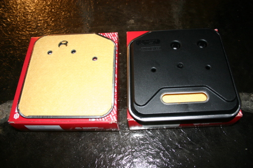

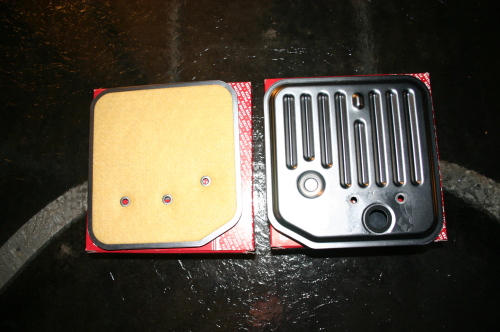

Don't honestly know at this point. I'm just passing on what my trusted tranny builder told me. It does make sense, but I have not tested it one way or the other. I purchased a filter for my 96 and my 99. I'm taking back the 99 filter and getting another 96 filter for the 99.
Napa numbers, 1996: 1-7957, 1999: 1-8565
Bottom View:
Top view:
