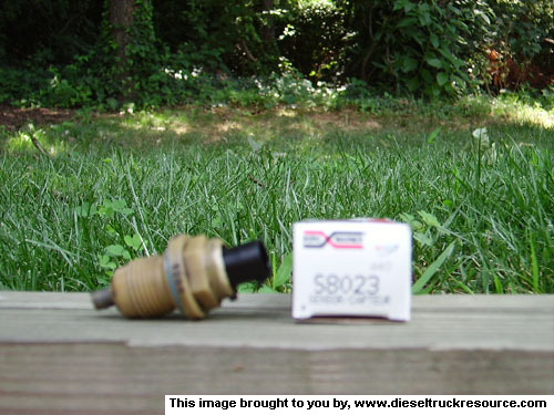

Mine did basically the same thing about a week ago.
But only on the 1st shift after a start-up.
A new Trans Speed Sensor (about $23.00 from my local auto parts store) cured my problem.
Look in my gallery for a picture of the sensor (located on the driver's side near the cross member) and the box with the part number.
https://www.dieseltruckresource.com/...29PICT0136.JPG
https://www.dieseltruckresource.com/...29PICT0134.JPG
Hope this helps
