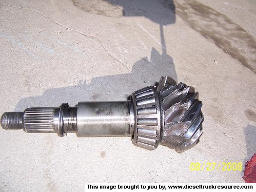

ok, I did the swap to the 4.10 gears front and rear, thanks for the replies guys. I will try to upload a picture of the pinion gear to day and post it on this thread. I tow the biggest pea gravel concrete pump they make, and I drive my truck like I stole it.

here it is: 8 teeth broken off and the 5 that were left had cracks as if they would have made it 2 more feet of driving, before they let go.
