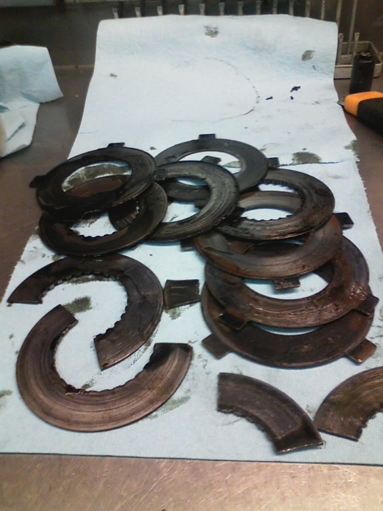

this is what my "factory limited slip" looked like, it came out like you see and cost approx100$ for me to replace the gently used parts

Good gawd! I hope mine doesn't look like that! Makes me want to yank my carrier and look!
