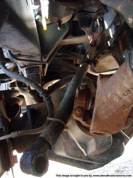

Old Apr 22, 2007 | 04:56 PM
fschiola's Avatar
Posts: 1,032
From: Where water boils at 193.4°
Well I don't know how good they are but here's 2 pics of my 2000.
This is looking up toward the end of the breather minus the bottle and the hose running down the left side of the oil pan.
This is taken from the rear of the truck looking forward. The hose passes between the cross member and the oil pan, lays against the diff and I attached it to a brake line to hold it in place. The pic looks like the hose touches the u-joint, but in fact has a lot of clearance there. I put a fitting in the end to try to get the gasses to point somewhat down instead of straight back. The total length of the extension is about 24".
Hope this helps.
