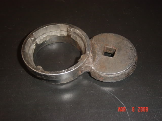

Some guys have taken the socket for doing the hubs on 4wd front ends and modified it to fit over the nut, and made it like a crowfoot socket.

1-5-3-6-2-4's Avatar
Posts: 3,142
From: Okotoks AB
yup

Do you know what 4x4 socket that was? from what I gather the stubbys have to be 60mm apart(measure the nut sitting here with me)
Also how is everyone holding the main shaft when retightening the nut, if I have the trans in first is there enough holding power from the engine or do I need the 80 dollar splined socket?

Just a spanner nut, you could borrow a spanner wrench, if you have a place that can waterjet, I can send you a file of the one I drew up and had made out of S7 tool steel....
I believe the nu8t calls for 300 Lb/Ft torque, so I doubt the front axle socket would deliver.

Not true. mine has delivered that time and time again.

IIRC, the lock nut on my front hubs is somewhere around 220 ft-lbs. 300 isn't that far away.

I wish I thought of that when I made my socket. I used what I had kicking around...some 1/4" square stock (keys), a 1 1/2" threaded floor flange, and a welder. Clamped the keys in the grooves, then ground down the lip of the flange so they fit, then welded them to the flange. Then bolted some angle iron to the flange, and letter rip! Quad4x4 had the actual wrench for fairly cheap, looked alot like the one posted above.
As far as holding the shaft when tightening, the motor won't do it. So you either need to hold the motor or pop the shifter and stick it in 1st and 3rd gear at the same time.
