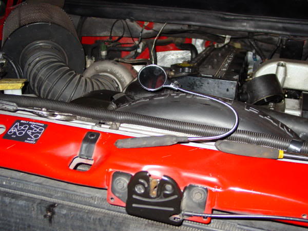

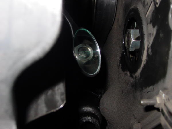

I used a flexible mirror so's I could see the IP shaft & key slide though the keyway on the timing gear.
