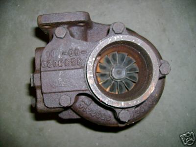

I recently bought an HX-35W but it was missing the exhaust part that has the v-band connected to it. It's the part in the attached picture which bolts to the turbo with 5-bolts and has the v-band connection.
My three questions are;
1. What size is the v-band.
2. Where can I get one new or used?
3. Whats the part number.

That doesn’t look like any HX-35 I have ever seen. 35’s don’t have v-bans. Are you sure it is a 35.
Old May 2, 2007 | 03:20 PM
35psitsi's Avatar
Posts: 9
It's marked with a holset tag: HX-35W. Either way, I found a way cooler exhaust housing in which I'm going to use from www.htturbo.com . So don't worry about it I guess.
Non-Wastegated sort of kind of.
These must be newer design.
Jim
Old May 20, 2007 | 10:45 PM
JDGnut's Avatar
Posts: 923
From: TX
Isn't that just an older 35.. that takes the seperate elbow and clamp?? Check out Ebay.. redliner (on ebay) sometimes has them listed..
Bryan
Edit: Opps.. your missing the 5 bolted piece... hhmm.. See them somewhere for sale.. might have also been on ebay...

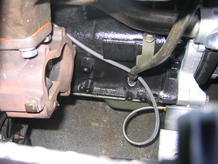

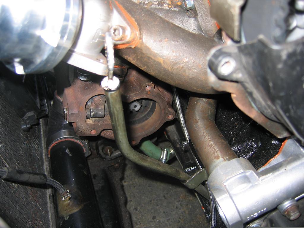

Alright, I'm going to be completely honest here. I don't drive a Dodge Ram. I drive an Eagle Talon. I put a Holset HX-35 onto my motor and I'm looking for something to work. This is how it sits right now. Pictures are as attached. I'm likely going to get a waterjet place in town to cut me the 316SS flanges for the 5-bolt housing and have a 3" v-band attached to it. It seems to be my only real option.
Attached Thumbnails Holset Question-img_0750.jpg   Holset Question-img_0749.jpg
