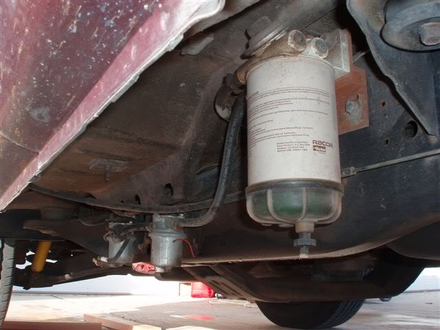

i'm using a 2 micron racor fuel filter ahead of the stock campaign carter frame mounted pump, it's been there for the last 7 or 8 years with no problems with either the pump or fuel pressure
