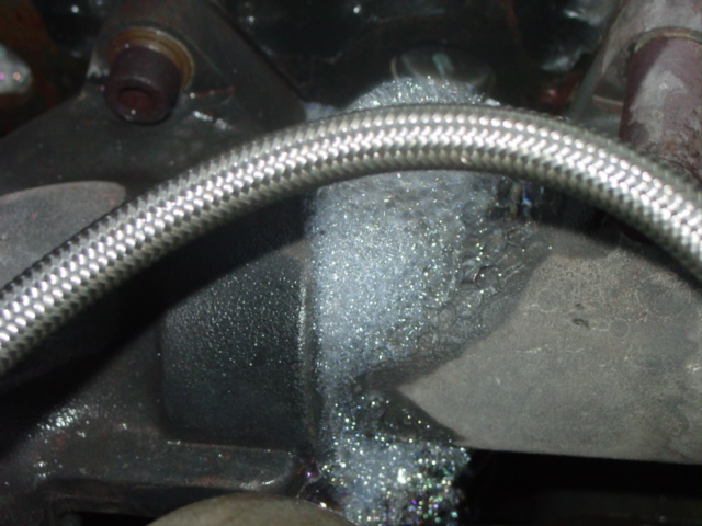

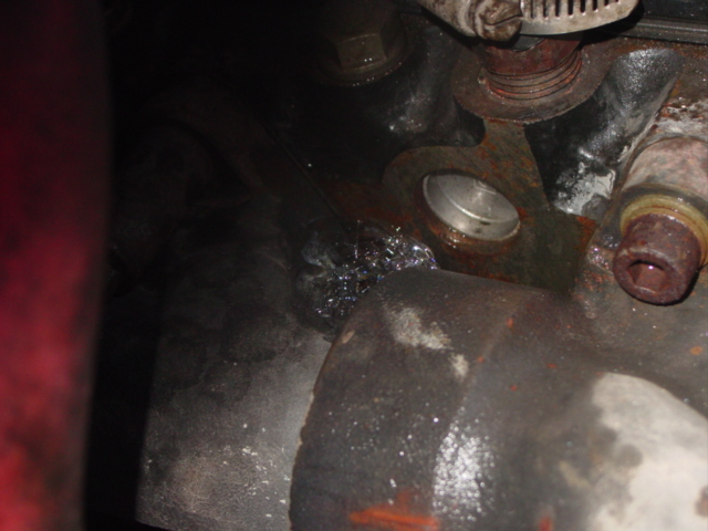

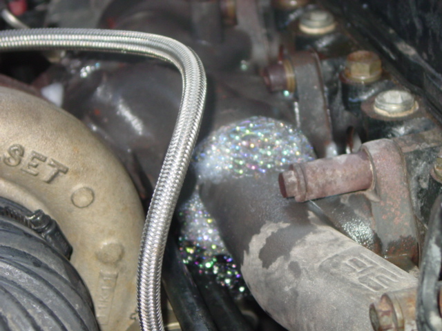

Ok i got a EDIT load of soap and poured it on every part of the turbo to the intake. I have a Huge leak where the 3 piece ATS manifold meets together. Would this cause high egts?

These are the leaks on the ATS manifold that was put together by them and powder coated. I would assume this would make a difference in the egts, seeing that the exhaust gases are escaping through these holes and not going in the turbo?

Originally Posted by mopar440cu
I have not noticed anymore smoke, I have not paid that much attention to that area. Whyy??
If you're getting more black smoke than you used to, it's a sign you have less air available to burn the fuel you're putting in.
I doubt those leaks on the exhaust manifold are causing your problem. Based on the pics, I don't see any soot marks on the manifold that suggest a leak while running. If that test was done cold, the contraction of the metal would allow small leaks that would be sealed when the engine is running and the manifold is warm.
Only being able to pull 30-32 out of the HX35 does sound somewhat low. Are you sure that your wastegate isn't opening prematurely? In any case, 35psi is pretty much the limit for the HX35 and based on your fuel mods, you do need more turbo.
But it should not be leaking at all, and if it is leaking your not pushing all the air to the turbo which you should be. Thus causing high egts and lower boost. Dont you think??

I've never run a multi-piece manifold, so I can't speak from personal experience. Having said that...
I would expect that a multi-piece manifold would have leaks when the metal is at ambient temperature. The places where the pieces intersect would have some looser clearances to allow the pieces to move. When you start the engine and start flowing warm air through the manifold, the pieces will expand and seal off the joints.
In any case, if you had a significant enough leak to cause enough drive pressure drop so that you couldn't spool the turbo fully, I would expect to see soot stains around the leaking areas since you would have soot escaping through the leaks when you're rolling smoke.
